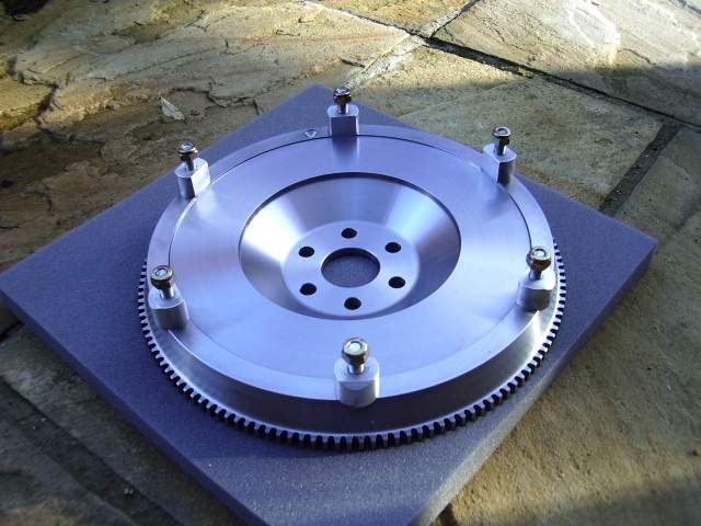

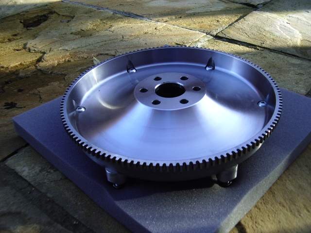

update;
you can now buy a z22se M32 lightened flywheel from TTV Racing £228 +vat
this means the slave cylinder does not now need any spacers, so simply fit the z22se M32 flywheel, Helix M32 sprung clutch plate (TTV can also supply a M32 sprung clutch plate), z22se clutch cover and the M32 gearbox with standard M32 slave cylinder.
makes the conversion a nut and bolt job :D

Hello. As you advised me I learned and came to a standstill.
Where did you buy that flywheel? Can you give a link? And the clutch disc?
TTV offers me a flywheel for motor z22se (lower than yours) - http://ttvracing.com/products/?manufacturers=opel-vauxhall&engine=opel-vauxhall-z22se&type=flywheels
Courtenaysport offers me the same flywheel TTV (lower than yours) - photo attached
I asked Courtenaysport also for Helix sprung clutch disc and they offer me only clutch disc Helix for M32 240mm 20teeth (Z20LEH) - http://www.courtenaysport.co.uk/buy...ung-uprated-organic-clutch-disc/prod_724.html
or (a Z22SE disc 228mm ??teeth - they have not yet responded - probably 14 teeth). I'm not sure that the clutch disc 240mm fit under the flywheel 228 mm. You can write me the clutch disc number - may still somewhere you have the disc number or select the link which the clutch discs you buyed for this instalation?

the flywheel shown above is for a z22se F23 - £213 + vat
you need a z22se M32 £285 + vat
I purchased my Helix clutch plate from Courtenay, the owner Jon sorted it for me.

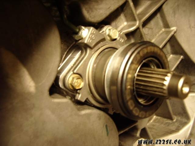

the M32 box is designed for a Dual Mass Flywheel puke..
to use a normal flywheel a spacer needs to be made for the clutch slave cylinder :roll:
EDIT: you can now buy a z22se M32 flywheel so the spacer is not required
the M32 has a distance of 59.5 mm between the mating face and the slave cylinder, the F23 has 46.5mm, so a 13mm spacer is required :)
thanks to Luna_s for measuring the F23 box cheers..
I also had to machine a slot to allow the clutch slave cylinder to sit flat on the spacer and use some longer bolts :)
the fitted spacer.....
