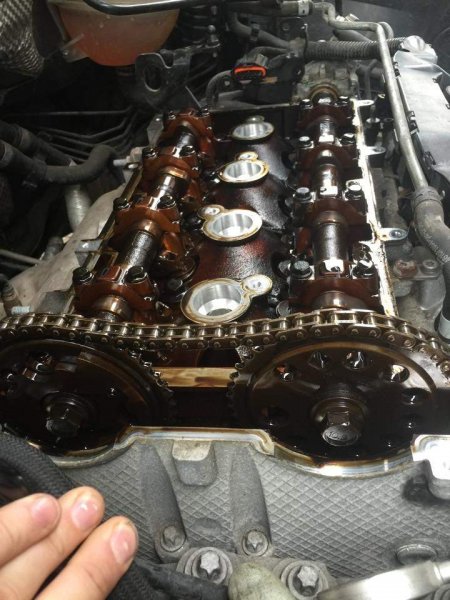

Progress update:
Removed the rocker cover and checked the tension of the chain ... no slack whatsoever.
While I had the top off I thought it a good idea to have a look around ... spotted what looked like one of the chain guide bolts loose next to the inlet cam sprocket.
With the help of a magnetic screwdriver, lots of fiddling and some swearing I managed to retrieve it.
Put it all back together and of course the same noise is there but at least we now know what the cause is.
Here's a photo of the loose bolt:
