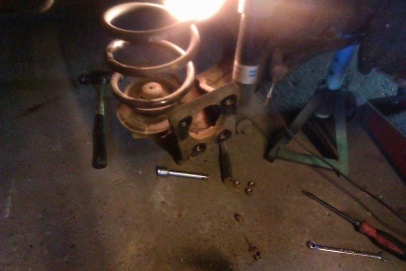

My rear brakes (drums and shoes) haven't been changed in the last five years since I had the car and the last MOT suggested the braking efficiency isn't too clever either. As a result I decided to opt for 240mm disc and pads, a little harder to find as mine is a 4 stud set-up. I managed to hold of a set (thanks sparke) and got some help (thanks Jason) to fit them. The calipers were fully checked prior to fitment as I know the Bosch are prone to seizing - but these seem in good working order.
In the garage ready for work...
Stripped down...
Wishing I'd painted the mounts too ...
Wheels back on...
Stripped down...
Wheels back on...
